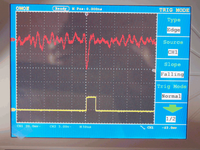

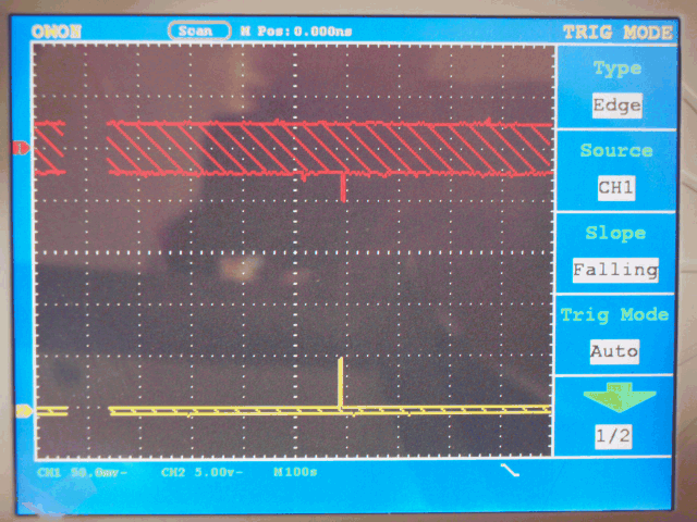

I have two of the SNM-10 B10 lined corona tubes, and tried them out with the same setup as in viewtopic.php?f=11&t=430&p=2756#p2756
The noise was approx twice the height of the same circuit running on the SNM18-1. It was difficult to threshold and problem-solve because, unlike the SNM18-1 that has around 6 counts a minute on background only, this only seems to fire 3 counts an hour.
The pulses are shorter;
and much less frequent (by factor 100);
