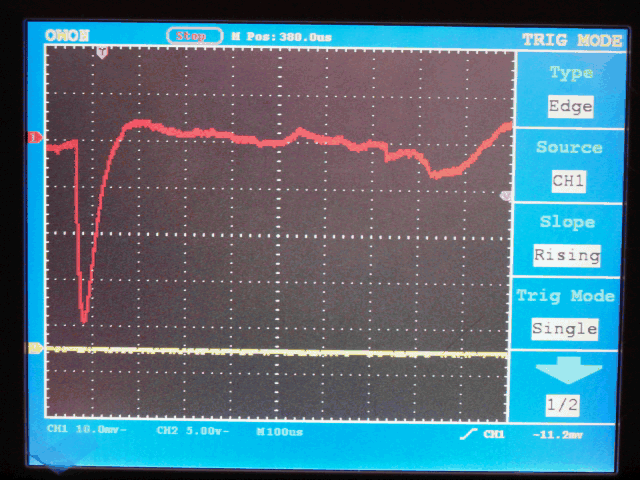

I bought a couple of 18-1 tubes some time back. This was earlier last year - before these 'corona tubes' got much of an outing in the forums, and I wasted a considerable amount of time trying to get the *** things working - and failed!
All this talk recently encouraged me to look closer. Well, with a new oscilloscope I bought in the intervening time period, it picks out the pulses! Cool!
Both 18-1 tubes work, giving around 4 to 10 pulses per minute background (little groups of bursts distort the minute-by-minute statistics, it seems). I also have two SNM-17 tubes, I tested one that seems to give only one pulse every several minutes, but bear in mind these have no moderation around them at all, so we're looking at direct cosmics, here.
I ran the tube with 100Mohm serial (seems to work fine - is there any benefit of the higher serial resistance?) and 100k to ground (this gives bigger pulses but doesn't actually improve the S/N that much). Whatever resistors I choose, the pulse seems to be around the 10pC worth of charge. I guess in previous attempts, my circuits were simply suppressing so little charge and I didn't notice the pulses just didn't become 'visible', and got swallowed up in noise.

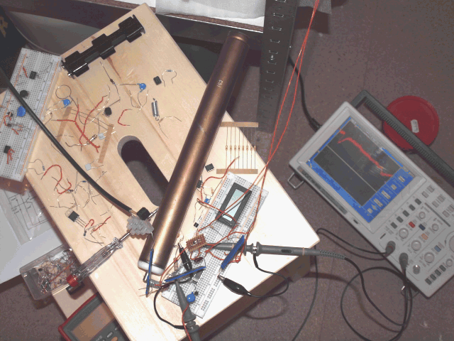

Now I turn to detector circuits... oh boy!!.. I went around this loop for ages - dozens of 'man hours' before already to no success. Similarly today and yesterday I've spent around 12hrs experimenting with damned circuits. Yes, Doug, I tried yours early on, at least with the transistors I have available. Maybe that is critical. But I found out something else, which makes me hesitate on your circuit. In one test, I manually adjusted the bias on a sensitive signal transistor to give a response. The circuit was set up to be 220kOhm input impedance. I did get signals, but it was significantly missing many out, it was only picking up the very biggest. So even with that high impedance, the signals still got pulled down.
I tried further and further, but the more I tried to push up the impedance of the detector, the further I seemed to get from detecting those pesky 10 pC's!
I don't know if the output on these tubes is a bit different to the ones you are running, but I am also sure I'm not skilled to make your circuit 'sing'. So I am planning on going to buy some JFET opamps and see if upping the input impedance gives me a more suitable circuit. I've spent too long now with the parts I have to try carrying on with them, so I'll try some new components, see if they give me the 'answer'. The cheaper JFET opamps can be found with 10^12 input impedance and 3MHz response, so I'll go for that level of spec first.
Here's all I have to show for a day's worth of 'effort'...

Just looking back on the posts for the other Russian tubes, gee.. the pulses from mine are (at least, as the scope sees it) muuuch longer. The trace, above, is set at 100us/div, whereas on the other posts the scope says 5us. Am I misreading this?

Chris -- yes, the transistors are important to that circuit, and if you substitute other types, you'll have to readjust the bias resistor (at least). The input pnp is a very low noise, very high gain type (but still cheap at most suppliers -- ). Obviously, if the circuit is biased so a transistor is all the way off or on - no output. It did take some fiddling to get the bias so the output DC resting value would stay in range over a couple of volts of power supply range -- that's why the big emitter resistor in the NPN, to cut down the DC loop gain some so it would work over the life of a 9v battery. The output collector has to be somewhere in the middle of the supply volts for the thing to work right. IIRC it was 4-5 volts here when tuned right (you have to check that there's a couple volts CE on the output transistor, because it could have a collector voltage, but the emitter volts are the same in saturation). A rising supply voltage turns on the pnp more and that turns on the NPN more and if it has zero CE voltage, well, you're not going to get much out of it....If you substitute a crummier pnp for the input (390x) then you'll have to fiddle with the bias feedback resistor to get things in range. The one specified is a "hot mamma" and has very high current gain (300-500) under the conditions. The bias is set up for lowest total noise with the input impedance. If you've got the circuit biased up right, touching the input with a finger should produce a full output wave (3v or so pk pk) at mains frequency or the local radio station.
As a side note, only a pretty experienced analog/rf designer should try substitutions in circuits I provide. I tend to take full advantage of the parts specced, and the "wires and parts that don't need to be there because I'm clever and used this to cancel that, etc". This circuit for example way outperforms the "not quite as simple charge sensitive amp" they went on and on about over at fusor.net -- with about 1/10 the parts. That's not accidental - 40 or so years practice with low level high speed analog design here.
You're likely seeing longer pulses because at the higher R, with the same C (the tube itself plus wiring) -- longer time constant. Takes a long time for the current through 100 megs and almost no volts to recharge the cap.
Not sure what type scope you have there, but mine (GW instek) when set up with "normal" triggering simply saves the last trace till the next trigger. For this low-rate stuff, it's a real advantage to have that, you get to see what happened. A regular analog scope isn't so great for this. I've also been able to use really slow sweep speeds, by putting it in "peak detect" mode. That keeps the sampling rate real high so it can show very skinny pulses even with a 10 second or longer sweep time -- or the cool "roll" mode. That alone is pretty good for testing your physics and tuning, as you can really see the rates as you tune things easily as they roll on past.

You'd see it fine with either scope. Say the sample rate is 25 mhz. That gives you 125 samples during a 5uS pulse -- which if displayed direct, would make the pulse about half the screen wide with a lot of detail on the pulse shape. If you use the "peak detect" mode with a slow sweep rate, the sample rate stays high, but more than one sample is shoved into each horizontal pixel width, in a min-max way, so you can still see one pixel wide pulses, even with ridiculously slow sweep rates, like 10 seconds/screen. I like the roll mode for this a lot. You just see the last N seconds scrolling horizontally, and the pulses show up as 1 pixel wide vertical lines off the baseline, and are very easy to see going by. I've had no troubles with the far shorter pulses from our NaI detectors as well and even with phototube/plastic signals (which are as fast as it gets -- a few ns). Don't know the specs on Chris' scope, but he's probably going to be able to do the same.
The fact that these, by default, keep the last screen up while waiting for the next trigger is a real boon with these "rare" signals. (They're not so rare once you get some D and some HV into a tank almost no matter what the configuration there).
What I see is that the real neutron pulses are well out of the background noise -- several times that is the norm, but not all the same height. This is because the n+B10 reaction may or may not throw all the reaction products straight toward the center of the tube, or into the gas at all, but some might just go sideways and bury themselves back in the tube wall before ionizing much gas.
The effect happens to an extent in any of these, even ones where the tube gas is the detection medium (3He or BF3). In use, we just set a threshold so the noise doesn't trip things, but any pulse well out of noise will. Since everybody's noise will be a little different, everybody's threshold will be too, and the net counts per neutron flux will also be different - you'll miss greater or fewer low level pulses depending on the threshold. A standard neutron counter is going to be a lot tougher to get to than what we're doing with the geigers, and this problem shows up all over the neutron literature -- these things are at best somewhat relative compared to the activation/measure method which CAN be calibrated pretty closely, but is only useful once you have a lot of neutrons. So, the idea is we use each tool for what it does the best. For tuning a fusor, a relative calibration is fine as long as things don't drift during a session, and immediate feedback on what makes it better or worse is really valuable. Later, once you've got a "tuning" and things are stable you can then do absolute measurement with the activation, and then have a number you can use to have at least a sloppy absolute scale factor for your tube detector.
