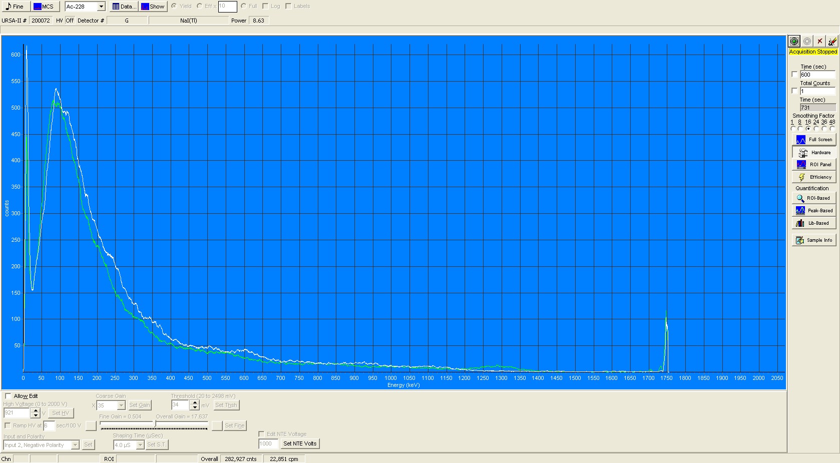

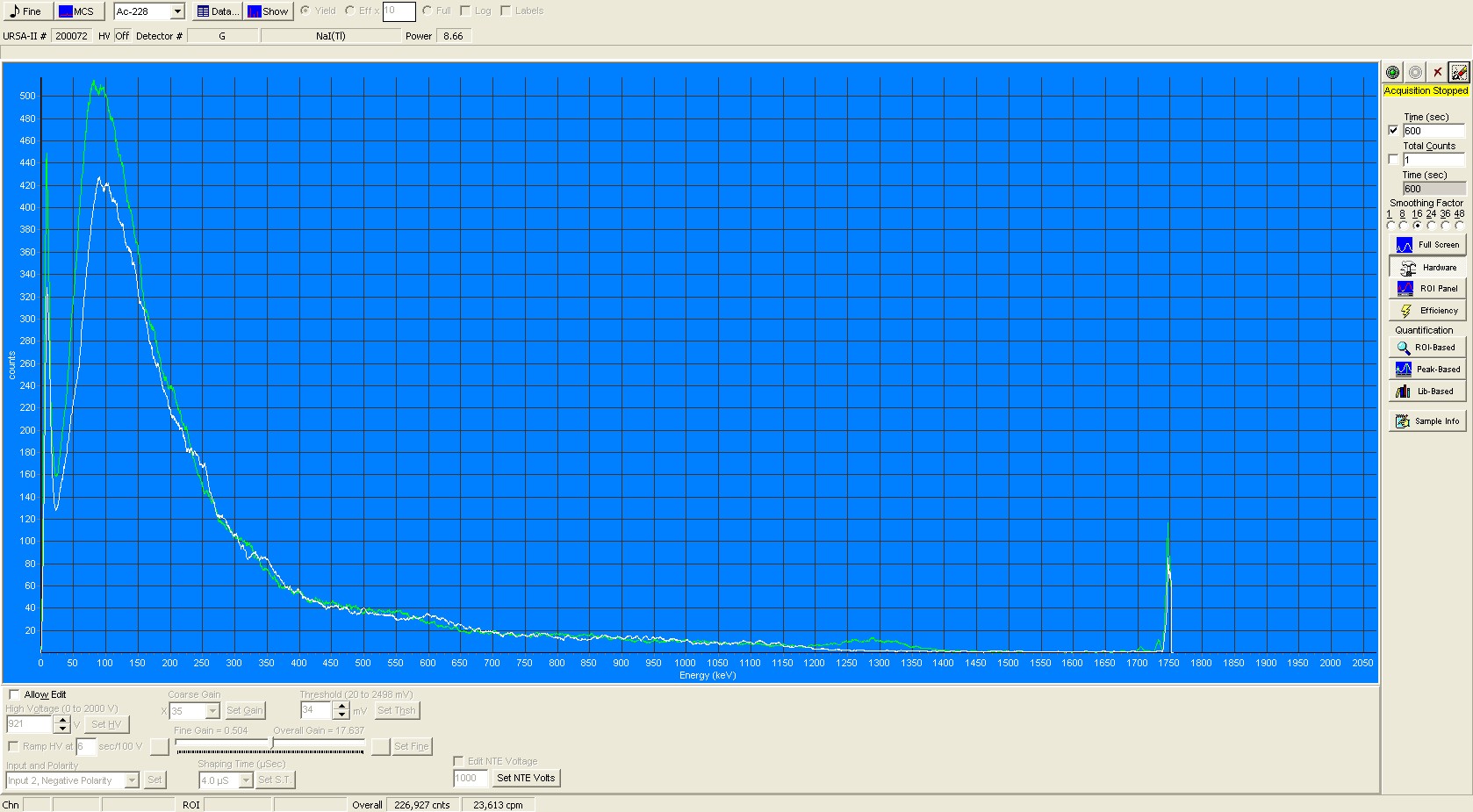

600 second background compare on Harshaw 6" NaI
This is two 600 second spectra of background, with the newer one in white. I re-calibrated as close as I could, but I think we can ignore height on the low energy left most peak, it's a real sensitive function of noise just out of threshold. Ditto, any shift probably won't show up in that rightmost one, due to that being where the a/d in the MCA clips (which could be a different place re energy bins depending on tube cal and HV). Less! Yet I checked downstairs, and it's still high there.
This one, taken separately against the same green reference, was let run 130 seconds more to get the basic shapes closer together so I could look at differences. As I said, the left most and right most peaks are noise and cosmics, respectively. It looks to me like the white trace is a little right-shifted to the green, but also that there are some things there that aren't in the green, and also something that is in the green but not here in white -- potassium?
Anybody with experience in these chime in - I'll do a subtraction and try to line match, and recheck the downstairs system which has been, up till now, really stable, and our recent runs weren't going to activate the lab -- nothing special at all.
Second with longer exposure to get the white scaled with the green older data.
