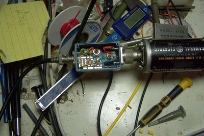

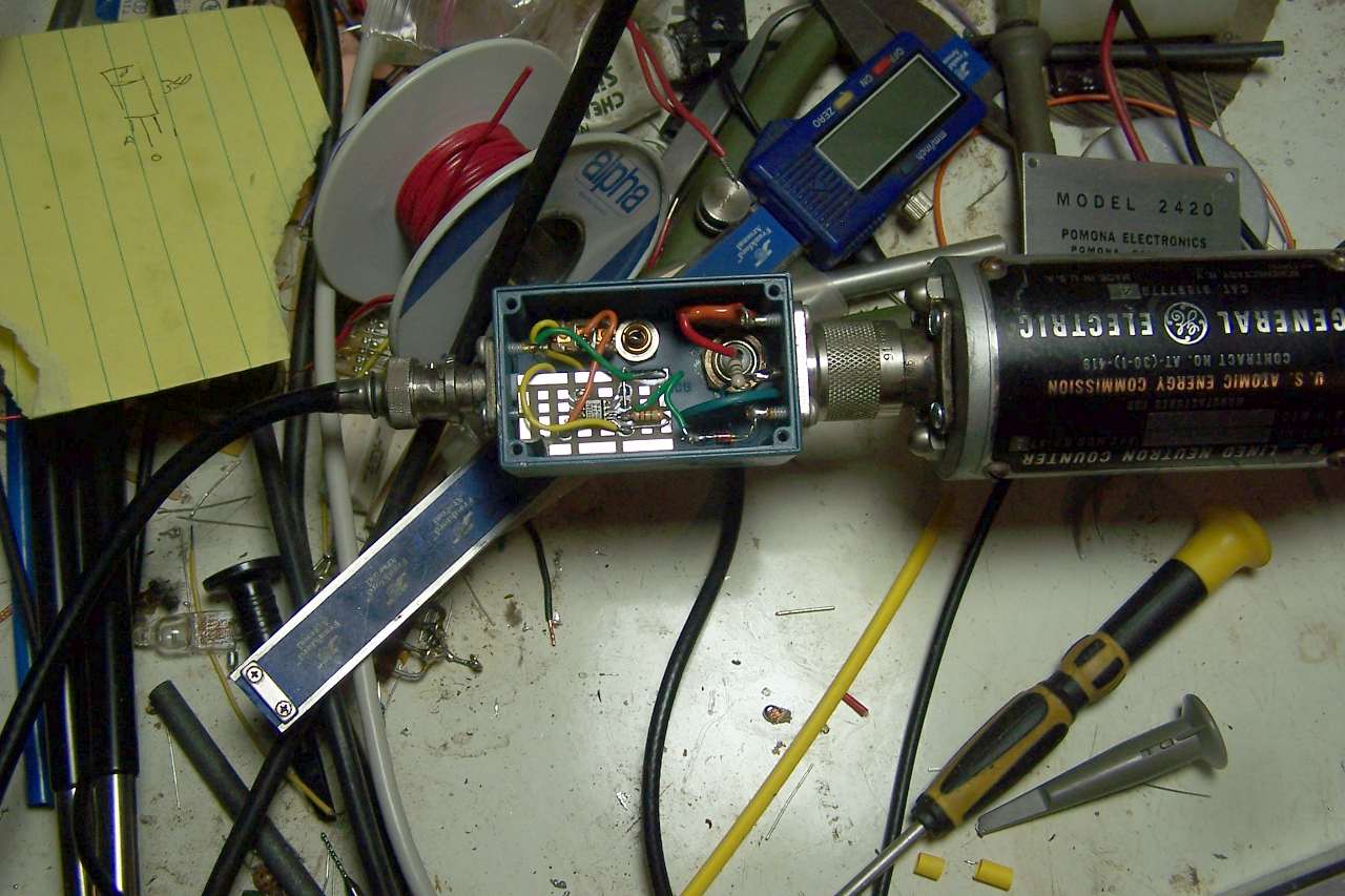

Here's what the prototype looks like. I changed the connector on the B10 tube to a type N to match what was already in the little box.
Preamp guts, very simple...not really, but it's elegant.

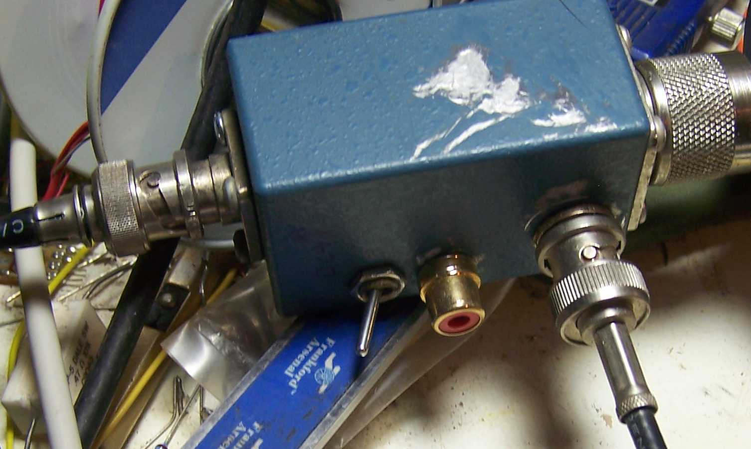

This was a tiny little box that basically came with two connectors, a 50 ohm small dummy load, and a diode in it. I adapted it to this use. The battery is in there, hot glued to the underside of the kludge board.
That made the panel busy, as of course, I had to have jacks for HV, analog and digital output, and a power switch. I skipped the led for this one -- would use too much power.
Busy panel
Busy panel

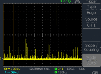

Here's what the output of the first stage preamp looks like with about the hottest source I have sitting on the B10 tube. This is a 1p22 spark gap tube (ra-226 and daughters since WW II), along with a piece of Th and a CS137 source -- I'm blasting the living daylights out of it here, and am a little nervous sitting close to this for too long. Each source is over 10k cpm on a geiger counter, some a lot more than that.
Response with a very hot gamma/beta source sitting on the tube.

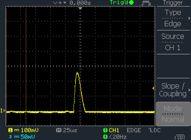

Here is what a single pulse of the gamma background looks like at a quicker sweep speed:
Single pulse shape, not so shabby

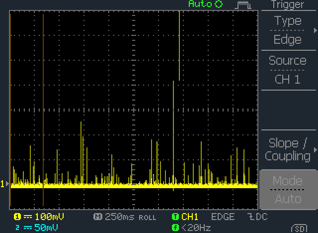

Not too bad. With no rad source present, I just see a few millivolts of noise (when the metal cover is on the preamp!)
Cosmic rays are the bane of any low background/high sensitivity situation. Here's what that looks like. I have the scope peak detecting so I can have it slow-scroll and still catch the tiny pulses, and in this case, caught it in the act of moving, but you can see the one huge spike there from a cosmic, which is about what you get from a real neutron -- 3 volts, or clipped, in this arrangement with just one Li cell driving it.
Cosmic hit with other rad source present

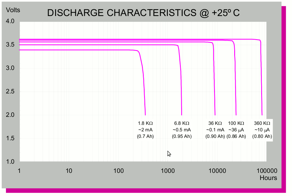

I am running this on a single Li cell, 1/2 aa in size (two fit neatly into an AA battery holder for 7v) that has volts over life specs that are real decent. Digikey part number is 439-1002-ND on this unit. And here's the volts vs life, the lowest curve of which is just the current this design actually draws. Pretty darn flat for a primary cell.
Li cell volts vs lifetime

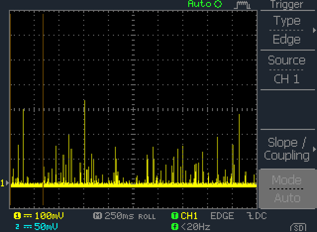

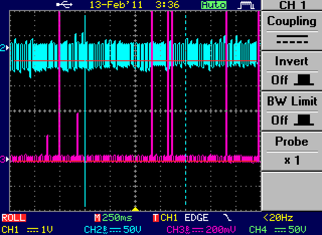

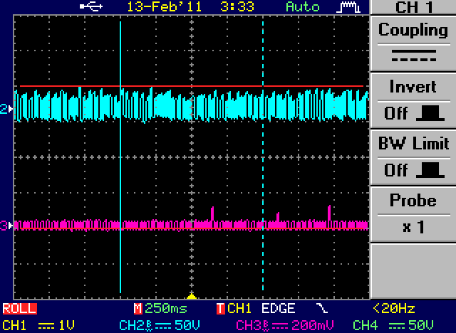

As promised, I did a fusor run with this all nearby. The middle of the B10 tube was roughly 4 feet from grid center, sitting on the floor, with a couple power supplies in between it and the fusor.
Tube was moderated inside a 6" diameter, 18" long piece of HDPE. Now I know where to set the threshold -- the very pleasing answer is "anywhere" -- I don't really need the second opamp half, strictly speaking, but I'll lash that up too so as to keep a separate straight output and get a buffered output to drive logic levels.
Fusor really isn't up to snuff right now, there's still that leak (we ran out of He trying to find it yesterday) and "one more mod" on that HV feedthrough needed, but it runs at all, which is well enough for this. The second issue kept me down to the low 30kv region, actually but that's still good enough for this, and at "full snot" I may actually have to move the tube farther away!
Here's some pictures. The first is the thing just waiting for me to turn on the HV for the fusor.
Fusor not running, background.  Blue trace is a faraday probe in the fusor to check for EMI/neutron counter co-incidence (and vert amp labeled wrong for this probe).

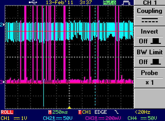

Now we turn the fusor on and try to keep it running long enough to take some of the money shots:
Setup as above but neutrons present
See above
See above
See above
See above
Note that I had to run the fusor in the less productive "stable" mode at high gas pressure to get these. That's really what the faraday probe is showing. It goes nuts during the higher Q pulsing modes, and ensuring a pulse type discrete counter such as this isn't just counting on EMI is one large pain -- which is why we do the thing with the silver as backup -- no way for that to ever be dead wrong. This is more useful for tuning and seeing quick things happen as you adjust something, the sliver is, well, the gold standard and final arbiter of real results. Room for just about all types of detectors here, and in fact, I forgot to turn on and look at the gamma ray spec head while I did that run, so down to the lab I go again -- that would be nice to know if it's useful as a fusion detector too (and probably easier for most than getting some sort of neutron tube going, unless you have too much money or luck on ebay).

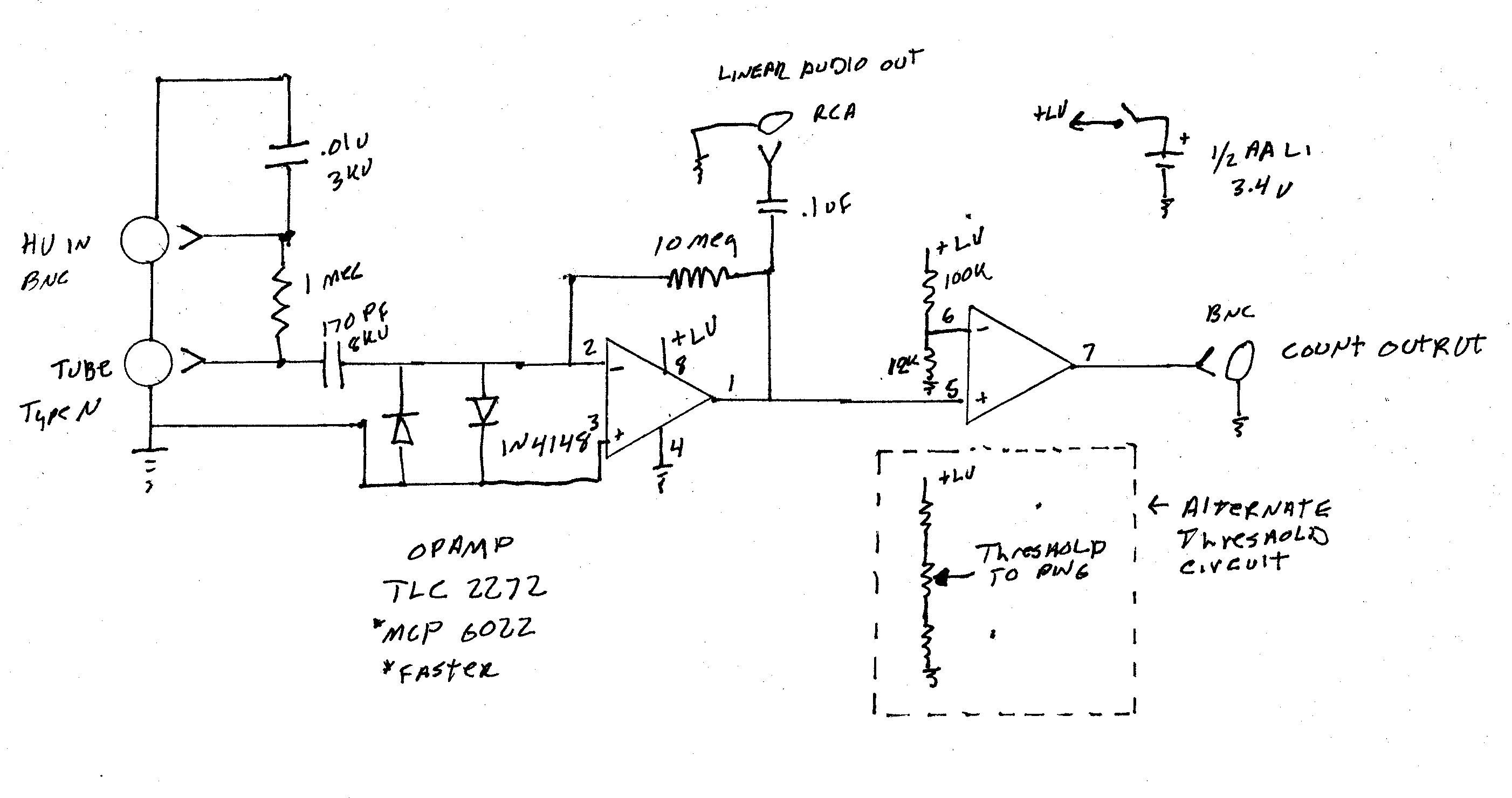

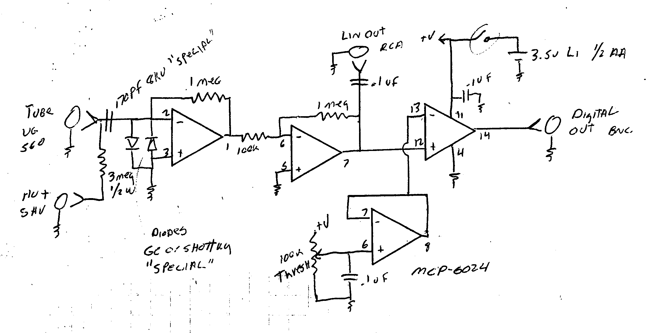

Here's the wrapup on this project. The schematic as finally finished is here:
Schematic for proportional tube preamp
Click on this for a bigger version.
I used the TLC 2272 here, because I had it in stock. It's a little slow, but then, so are these tubes, so it all works out. A too-fast opamp would just allow for more troubles with oscillation and noise pickup. For a little bit faster response, I'd use the MCP 6022 in this circuit. It draws about the same power, but is a newer tech, and I've had good luck with those too in similar uses.
The schematic shows another way to generate a threshold. For this one, I just used fixed resistors because the threshold was far from critical, and a pot is bigger, less reliable, and costs more.
But if you wanted something a bit more generic, that would be the way to go. I show resistors above and below the pot so by adjusting all three R values, you can make the adjustment less touchy by having the pot cover a smaller voltage range.
Old-school opamp jocks will perhaps have kittens on some of this. No bypass! It's just not needed with an Li cell and short wires. No hysteresis on the comparator! Again, simply not needed here. You would need these things with older tech, a sloppier larger build, or much faster opamp -- more isn't necessarily better in this game. Heck, I didn't even use a reference diode to create a stable threshold. It's not needed here due to the very flat curve on the battery voltage during discharge, and the wide margin that basic tube provides.
I could have added a small series R between the input coupling cap and the diodes to limit diode peak current in "hot plugging" -- but really, you shouldn't do that anyway with HV already on, and with the tiny cap value, even 1n4148's will probably take the impulse that generates. I'd rather fry those than an opamp, at any rate. I was simply running out of room on the tiny surfboard, and didn't want to add extra complexity anyway. Really sharp-eyed old schoolers will notice that the input stage is slew-rate limiting on the front of large pulses -- so? We're not doing low inter-modulation distortion audio here, it simply does not matter. Now, if we were doing a fast gamma ray spectrometer off a phototube, with 5-10 ns pulses, it would matter, but we're not -- that design will be up here later on, and it is trickier when linearity matters and speeds are very quick.

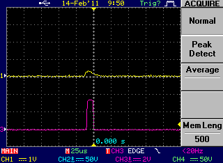

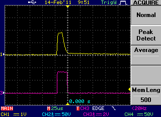

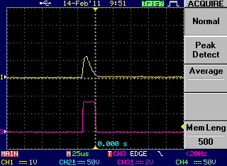

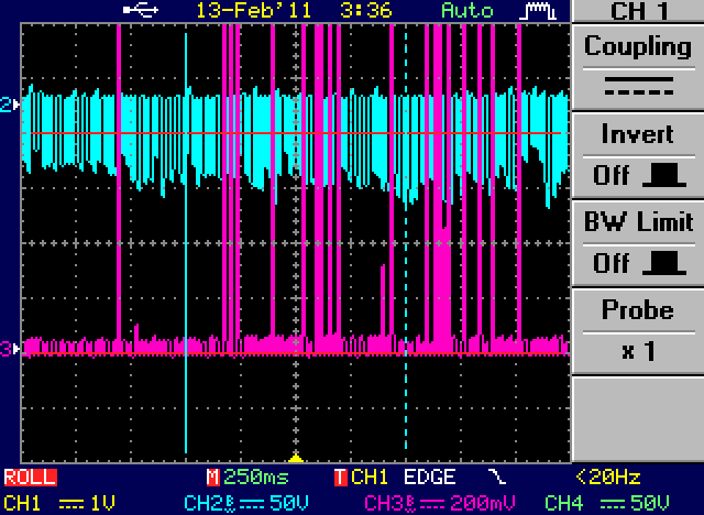

After building this up, putting on the lid, of course I had to test it. Here's some waveforms. I had a chunk of U sitting against the tube, and a neutron generator (very weak one) also sitting on the moderator. I'd guess most of the actual counts shown here are really just cosmic rays, but even then the count rate was quite low -- several seconds between counts and clicks on the audio amplifier.
Waveforms
Waveforms
The upper trace is the linear output, the lower is the digital one. You can see the noise from the U gammas and daughter betas in this if you look closely.
As you can see, I got away with no hysteresis, and no bypassing here just fine. This is about as sweet as it gets in this kind of work. The digital pulses go to about 3.3v, which is a high in either TTL or CMOS even if those are 5v powered, and right on down to ground, no glitching, and the rise and fall times are nice -- not so fast as to create ringing on a decent cable, and not so slow as to create noise-induced false counts either.

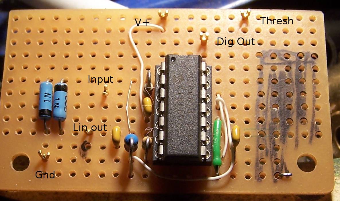

Front side of kludge board
I used a socket, not ideal from a noise point of view (or parasitics) but nice if I have to change the amp out for whatever reason. Sorry about the hairs in the pic, this is not a clean room!

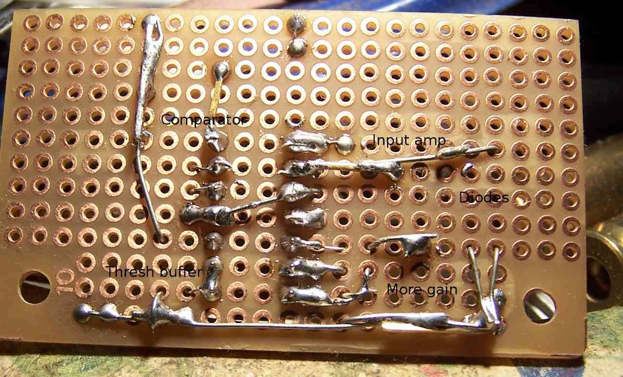

And, here's the other side. I instinctively do this as though it were a PCB layout even though you can really "cheat" on these. But the next time you want to change parts, and realize you used component leads for "tracks" -- you'll learn.
Back side, flipped L-R, top is still top

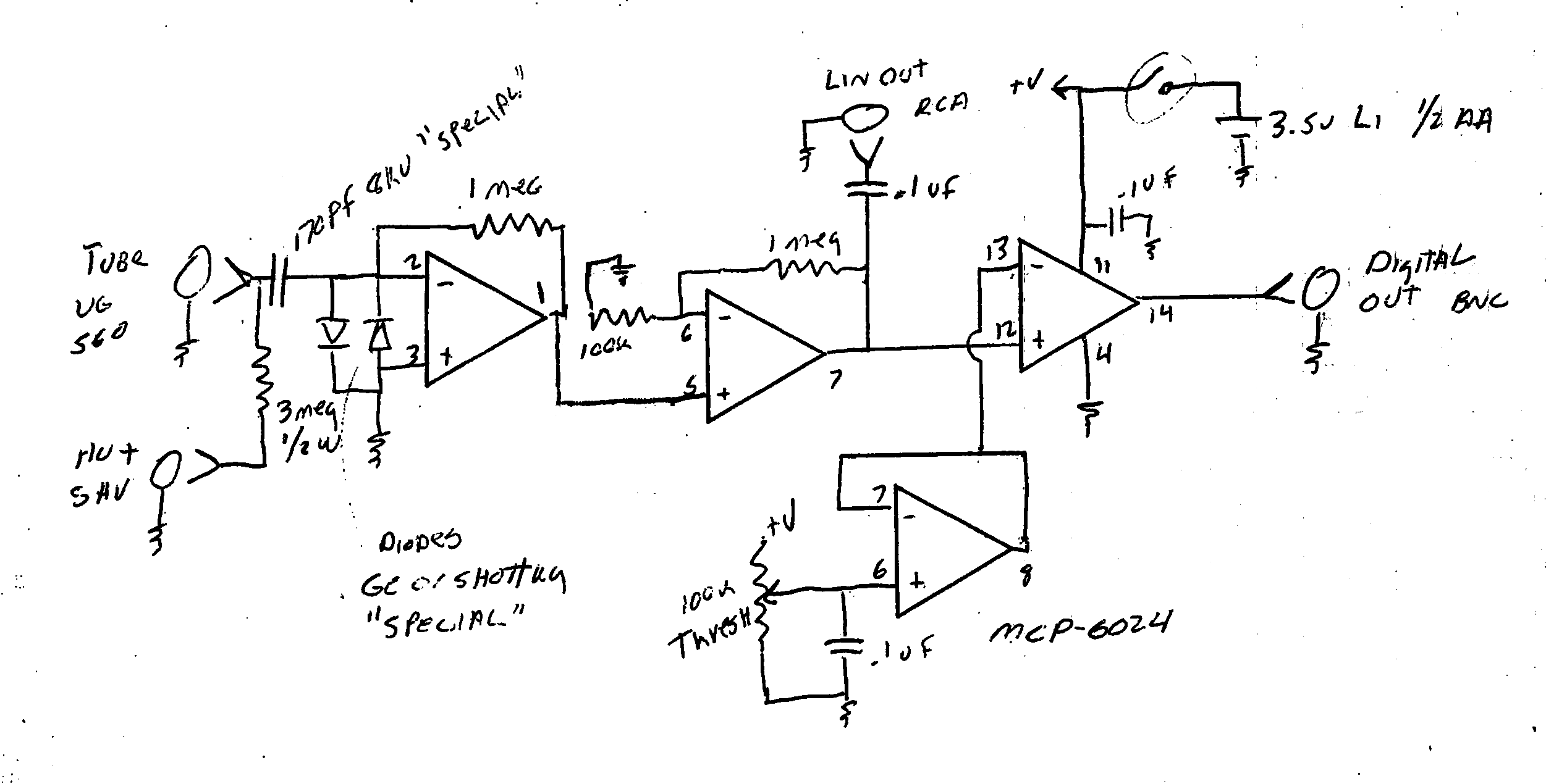

Here's the schematic:
Schematic as built
Schematic as built
Notes:
All caps are generic .1 uf ceramics except the special input coupling cap, a special low noise 8kv 170 pf ceramic.
The resistors are mostly non critical. The one from the HV to the tube has to be large so it won't arc over in case of a short (and maybe fry the tube in the process).
I used RCA for the linear output, SHV for the HV input, BNC for the digital output, and the crazy UG-560/U for the tube (since that's what's on the tube). This will screw right on the tube in use, like the other one, this box is a little bigger so I didn't have to cram things in as tight (pix to follow, after I test and do any mods required).
The input protection diodes are a little strange here. They have to turn on quicker than the ones in the chip to make any difference (or you need a resistor between them and the chip input pin). I happened to use some very bizarre germanium power diodes (ampere ratings) I had laying around (inherited from an older engineer), but schottky should do fine here too. You want them beefy enough to handle the full peak current that 170 pf cap can put out if the input is suddenly shorted...In other words, they're not needed if that can't happen and you're careful.
10 points for anyone who notices the wire that's on the schematic but missing from the pictures (going to fix that now).Or for that matter, an error I drew into the schematic. I'll give you that one -- I actually configured the second gain stage non inverting, with the 100k to gnd and the feed from the previous stage to the + input -- and it matters, oops, as this is all based on ground levels and the opamp can't make negative of ground outputs. The way I actually wired it, I'll get positive going output pulses. If you do it like this schematic...negative going (if the + input had been biased off ground). Counters would not care one bit. I'll fix that when I redraw the final schiz after testing and any mods.

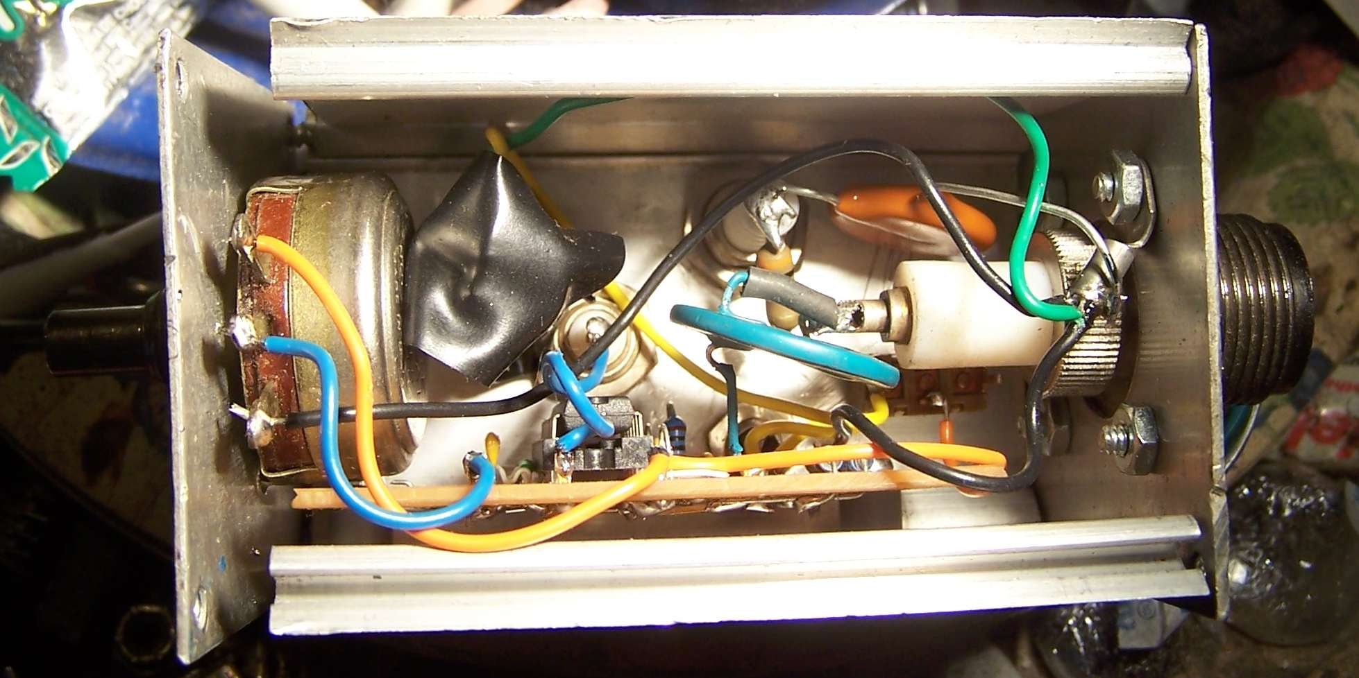

Here's the result, almost ready for use -- just have to add the missing side to the box and crank in the screws.
Build up
Build up
A couple of build notes. I added a HV bypass cap so I can do the same trick with the power supply for this I did for the other one. It's the red cap. The big green guy is the 170 pf coupling cap.
Note that in either case, I paid attention to which side of the cap was at ground (more or less) to reduce in-box corona and noise. I used an old Allen Bradely pot for the threshold. Once I find out where it would be set (in conjunction with probably lowering the ~3k HV supply to get in gain range) I might add some resistors to reduce the range of the threshold adjustment.
The battery is the thing in black tape. At the 4.7 ma measured this draws, it won't have a super long life, and I was tempted to put a led on there to remind me to turn it off when not in use, but then again, that wouldn't help the life either...can't win. They do make a full AA size of this guy (twice the capacity) and I'll order some soon, but -- not cheap, about $7 each for 2 amp hours.
Again, the reason to use this rather than say, 2-3 regular AA's is the flat voltage over life curve that saves other parts and current drain of a voltage reference.
