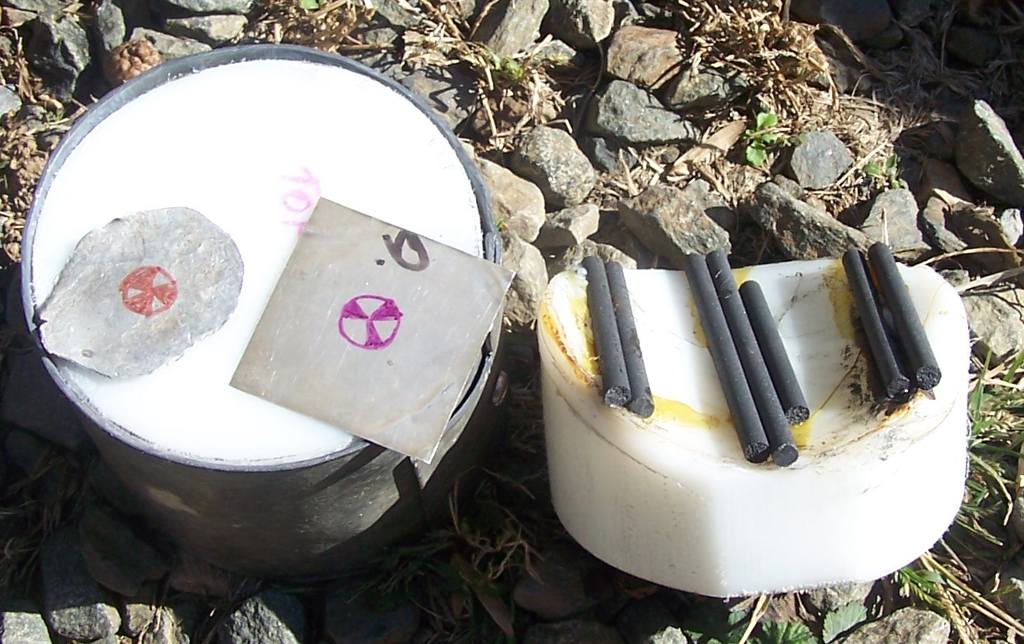

So the main variable once we have geiger counters that agree is the neutron oven. Carl Willis calculated the best thickness between the silver and the source as being about 1.5" of HDPE, so that's what we use on that side. On the other side, we have about 3-4" more HDPE behind the silver to help reflect neutrons back into it, as the moderation process works that way -- random direction changes of the neutrons. We have the 'input side" more or less touching the tank wall, or 3.5" from the grid center. Changes in spacing are fairly easy to take into account mathematically for those using a different size apparatus or spacing, and are not too severe if you stay fairly close. I basically cut up a 4" diameter HDPE rod so the bottom matches the tank curvature, made a cut through where it was 1.5" thick at the thinnest point due to that curvature, and put the rest on top of the activation sample. I found setting it right on the tank not to be so good -- the tank gets hot enough to melt it, so I glued some carbon rods on the bottom that space it up about a quarter inch to let some air get under there for cooling. The whole thing is placed in a hole in the lead shielding I have all over the rest of the gear to keep the X rays down in the lab (which is a good idea in general, square law only gets you so far).
Above are the parts of the neutron oven, with the bottom upside down so you can see how I cut it to fit my tank, and the carbon rods I used as spacers so it would stop melting.

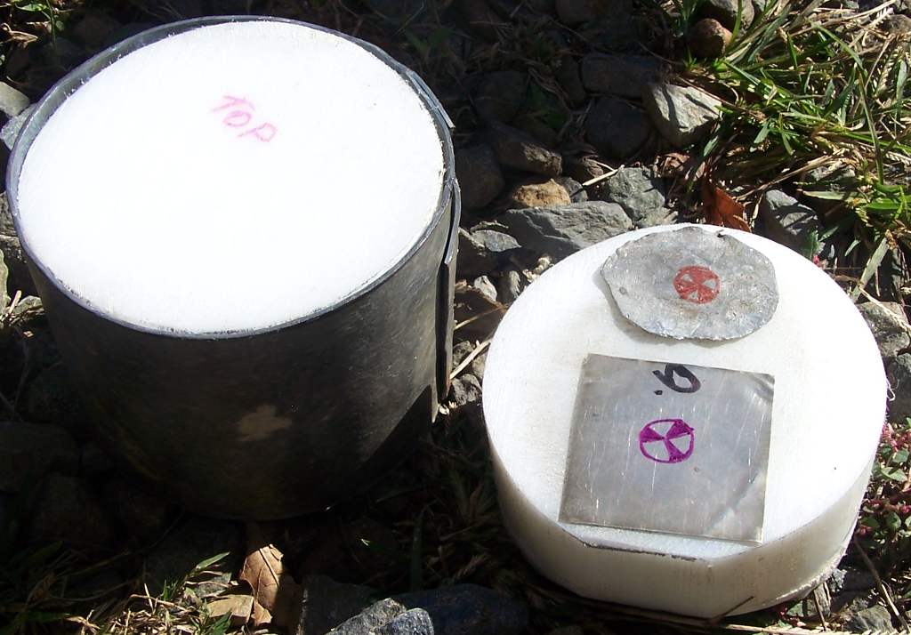

Here is the oven with the base right side up and the activation samples sitting where they sit during the process. The odd shaped one started as a pea sized piece of indium I pounded with a hammer. The other is a 2" sq by .01" thick piece of 99.9+ fine silver.

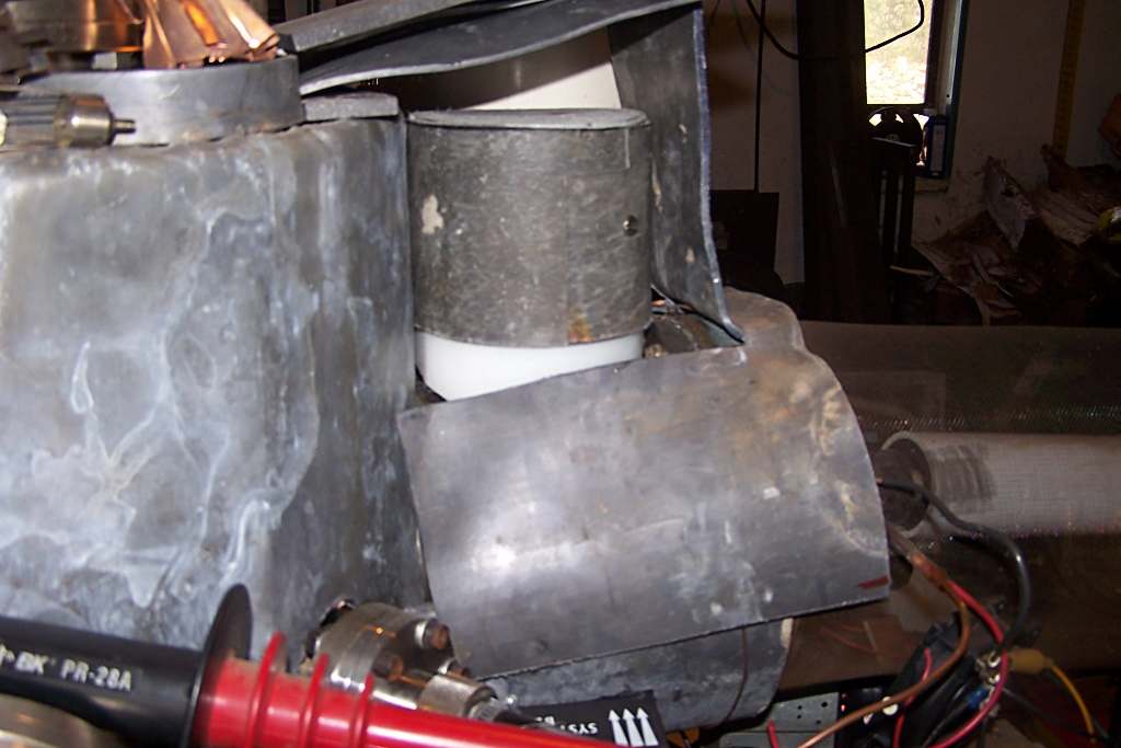

And here it is ready to go, on the fusor. My cylindrical grid is in the sidearm the oven sits atop, in a hole in the shielding so it gets everything full blast. The HV for the main grid comes in from the back/right in this view. As you can see, I have reasonably decent lead coverage, even though I sit well on the other side. X rays do scatter, and my wife sits above this to watch TV on the floor above...The lead pretty much stops all the power supply energy X rays, but not the neutrons or the real hot gammas from fusion. Obviously there is more I could do with shielding here.
The HV probe in the foreground is looking at the power to a supplementary grid I have out in the main volume of the tank, as an ion source and pulse inducer for the main rig. Pretty cool, works a charm, and there's a lot more left to discover with that setup.
